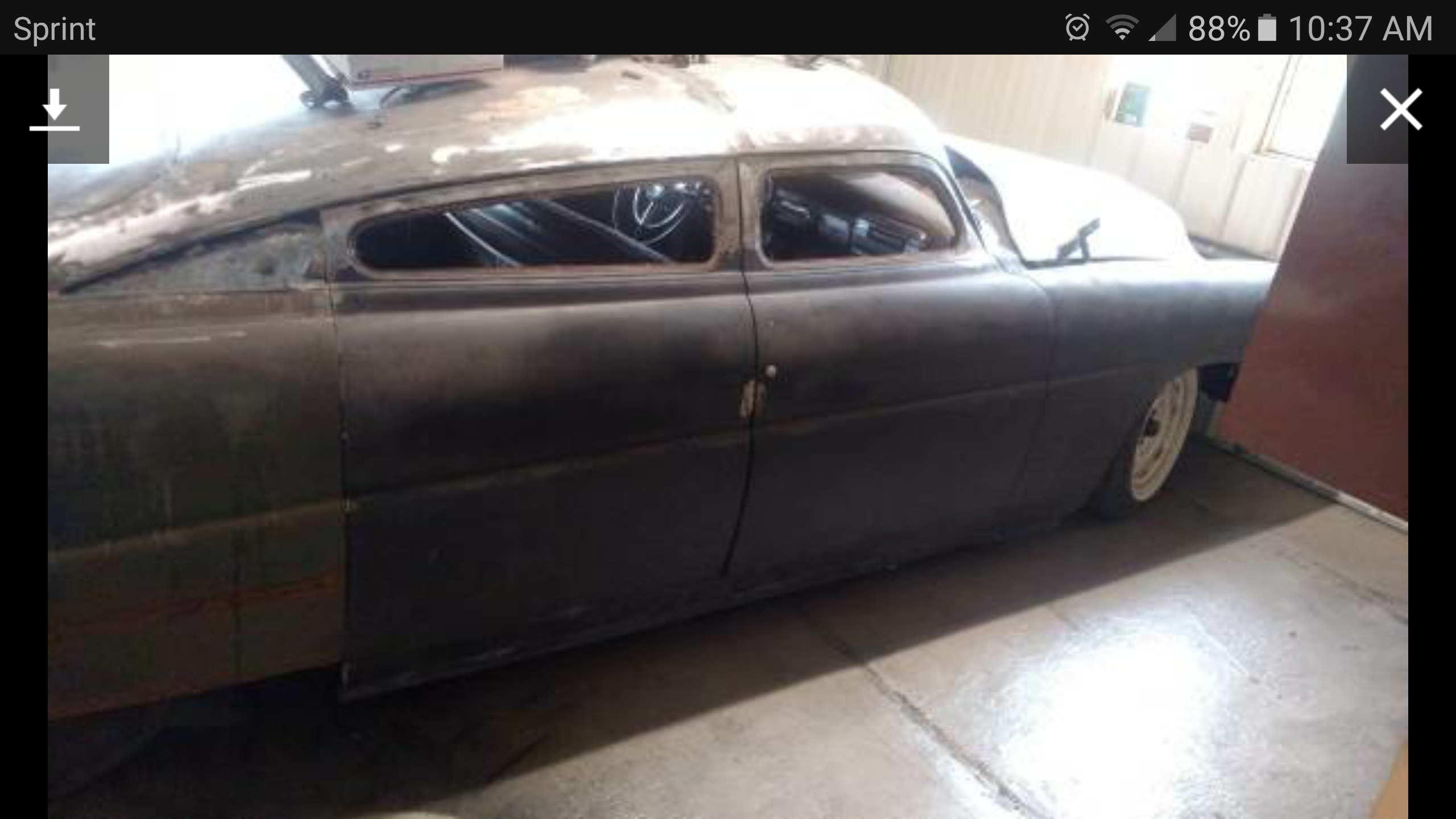

Just found this post. Is this low enough? Stock front suspension.0
