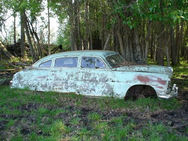

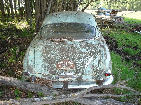

Hi, just joined the forum in hopes that someone here could help me identify this car. It's been in our back field since 1955 when my father helped the owner dismantle the motor and remove the transmission. The owner could not afford to pay for the repairs to the transmission, so it's sat in our field ever since, the owner and his heirs having all passed away, we were wondering exactly how old this car is. My uncle guesses it is a 1946, but we don't know for sure. Hoping someone here knows the year and exact model. The little silver decals say it's a wasp. The grill is not pictured as it is in the trunk with the motor that my dad helped remove and quite frankly, I'm scared to open the trunk for fear of what critters might be inside. Here are three pictures I took this afternoon.
Thanks to all for looking.

  • Hi It appears to be a 1952 or 53 Hudson Wasp. What are you planning to do with her? Steve

    Curious where you are located- its in remarkably good shape, rust-wise, for having sat out for 50 years.

    I'd be concerned about it sitting in the dirt - the bottoms of the "frame" rails could be gone in several places.

    The casr is a '53 Wasp
  • 53 Wasp, check the hood ornament.
  • Sorry, ment to say 52 Wasp

  • i highly doubt this car has been sitting since 55, i think the paint would be in worse shape. but you never know?!
  • 52 or 53 doesn't jive with what my uncle and my dad were saying. My dad claims it was an "old" car when parked. They could be mistaken though. I saw someone mention the hood ornament, would the year be somewhere there? Or perhaps their memories are confusing what year they retired it to the bush. I might go out for a walk later and see if I can brush enough moss off the license plate to see what was the last year the car was registered.
    The grill is in the trunk, according to my father, but his memory might be a bit rusty.
    The car actually has remarkably little rust on the body, there's a tiny bit at the very bottom of both of the sides of the car, and none that I can see anywhere else. It has been parked under a very thick bunch of trees for the last 50 years or so. It's quite well protected from the weather by the trees, as we live in northern Alberta and the outside of that car looks that good after sitting through half a century of Alberta winters. I think the worst of what you can see in the pictures on the paint is actually moss, which is how you can tell that's the north side of the car. LOL.
    The tires are gone, the rims are probably still hanging around here somewhere as my grandfather had a habit of taking parts off of whatever he could find and integrating them into wagons to pull behind his horses and such. LOL, there's quite a pile of stuff back there, I'm sure they can't be too far away.
    The transmission was never returned here as the owner could not afford to pay for it, I have no idea where it ended up.
    And as for what we were planning to do with the car, my uncle and I are talking about seeing if we could clean it up and get it to work. At which point we'd extricate it from the dirt. It actually looks like a coyote might be using the space under the hood as a winter time home.
    Although, like you said, the condition of the underside of the car is a mystery. It is sitting on a spot that is very rarely wet, the ground always seems hard there, even in the spring, so I couldn't even guess. I can tell you that what I can see of the inside of the floor of the vehicle doesn't look to be rusted through.
    Any other information I will have to go locate and drag my father from his fishing boat to give you. I'll quiz him further tonight.

    There's no question that the car is a '52 or '53. As to the condition of the underside, you would want to very carefully check this before committing yourself to fixing the car up. These cars had an integral body and frame (almost universal nowadays, but quite unusual when your car was new). The perimeter frame was of a lighter gauge steel than the standard frames used in body & frame construction. When these cars were left 'out in the elements' or driven on salty highways, the perimeter frame tended to rust, and a frame repair is a very involved operation. Looking at these pictures, with the car sitting right down on the ground, it seems quite improbable that the frame has survived intact. But then...maybe your earth has embalming fluid or natural mellowing agents in it, LOL!
    Anyway, do carefully check the perimeter frame (after you lift the car up), especially aft of the rear wheels, before making any decisions!

  • Trunk Handle Identilfies Ils As A 52 Pacemaker, Not A Wasp
    Bill, I was thinking 52 pacemaker, as well, mainly due to the trunk handle and lower hudson emblem, absence of the higher end window trim, but the owner said the trunk emblem said wasp. I can't think of another fit, but a 53 wasp.
    Only thing I can't figure out is that darned trunk handle/emblem. But 53 wasp makes sense for everything else. Does anyone think that this thing being perhaps canadian, has some bearing on the trim/emblem package?
    Did 53 wasps have the older style hood ornament, like the one Ken attached? Do 53 Super wasps have the hornet style hood ornament?
    Right now, I'm going with 53 wasp, but would love to know the VIN to see who might have guessed right.

  • I think our model confusion is because this is a Canadian Hudson. If I remember correctly, the northern Hudsons used some Pacemaker trim on some Wasps. Maybe 51HornetA will be able to shed some light on this car.
    The handle does say Wasp on it. I will try to see if there's a VIN number that's readable on it when I get the chance.
    This is causing a major argument between some stubborn old men in my family BTW. They refuse to believe that it's a 52 or a 53, so now they're arguing over who last rode in it and when and how old there were when they did so. I think I'd rather trust my mom's memory, she says she rode in the car when her and my dad first started dating, so according to her it was still running in 1957. (BTW, my parents are now arguing over that date as well. LOL) This could get ugly.
  • As soon as he can get to the vin number we can tell. Canadian Hudsons used different model numbers than the US models. And yes the Tilbury factory did use Pacemaker components from the 52 year on the 53 Wasps so we may have an answer there as the model changed over in 53.
